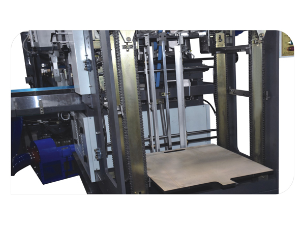

自动贴标机性能特点 Characteristcs
本机主要应用于天地盒礼盒灰板纸、密度板四个角的贴合,自动送纸板、冲压、自动送胶带、贴胶带、出盒一气合成。可单独使用、也可与半自动配合使用。体积小、功耗小、速度快、节省人工提高效率。
This machine is mainly used in world box paperboard boxes,MDF four corners of the fit,automatic feed cardboard,stamping,automatic feed tape,taped,stretch out the box synthesis.May be used alone,can also be used in conjunction with a semi-automatic.Small size,low power consumption,fast,save labor and improve efficiency.
产品详情
TB-TJ-400自动贴标机优点 Benefits

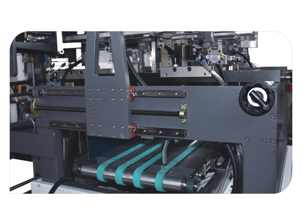

1.纸板飞达自动送,循环换板不停机送纸,可堆放1000mm。
2.更换模具只需拆装2颗螺丝,盒型大小螺杆摇动调节,更换规格15分钟,简单快捷。
3.胶带纸自动输送、分切、贴角,一次性完成四个角贴合。
4.胶带纸用完自动报警,胶带纸单次Zui长可输送80mm。
1.A Cardboard feeder automatic feed,the feed cycle without stopping the machine for board,can be stacked up to 1000mm.
2.Replace the mold just two removable screws,screw size box type swing adjustments,changing specifications of 15 minutes,is simple and quick.
3.Paper tape automatic conveying,cutting,fillet,once completed the four corners fit.
4.Tape the paper runs out automatic alarm,the longest single paper tape can be transported 80mm.
